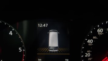

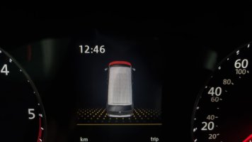

Interesting... and indeed the following messages/parameters are available in T6 EU6 engines:
Obviously another thing to keep an eye on... if these really are live parameters or just blank "placeholders".
... The warning is reset by opening/closing the bonnet ...
Sometimes bonnet locking mechanism micro switch gets mechanically stuck,
therefore constantly indicating closed bonnet(regardless if it is actually opened or closed).
In order to verify that, just open the bonnet and check your Instrument cluster centre display and see if the bonnet being opened is actually indicated.
Should this be the case, just remove the locking mechanism apply appropriate lubricant, wiggle the micro switch to free it up and reassemble the whole thing.
