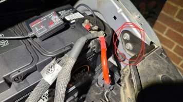

Would anyone be able to tell me the screw size for the +ve terminal and a suitable grounding point for eyelet terminals for the Genius5? I presume the headlight bracket would be suitable? I'd like to connect something like this so Mum can just plug in with the quick connect, rather than mess about with clamps: NOCO - X-Connect Eyelet Terminal - GC002 but they do it in M6, M8, and M10 and as I live quite a way from her, I can't just pop round to measure myself.

Now, if someone could either: 1) tell me of a product that can clamp on the negative terminal after the shunt that I can connect the eyelet terminal to, or
2) a simple screw on the chassis I can connect to that won't mean the engine drops out of the bay when I unscrew a screw connected to the light bracket,

Our @roadtripper posted a lovely photo a while ago of the bolt to the rhs of the battery. I'll post one later if nobody else has...

The clamp bolts on my battery (T6) are M6. There is no easy way to clamp to the negative close to (but after) the shunt so easiest to use one of the 2 bolts to the right of the positive - marked below:
There is also a chassis ground point in the scuttle which can be seen through the slatted bit of plastic just above the battery - the point is inline with the negative side. Would mean some dismantling to get to it. Just visible on this pic:
