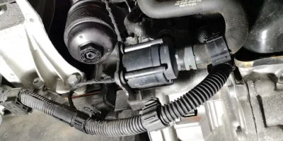

Oil filter location? 150PS
now this is what i thought but it looked "upside down" for me.
Is it much spillage to replace it without touching anything else? ( i have replaced oil already).
is there a plastic sump on this picture? or is it that 8 bolt cover people are on about? (my van had no covers)
am i for some nasty surprises or does it work as it did in caddy? (remove top, it comes out with filter attached, snap filter off, snap new one on, replace seal screw it back in)?
Reactions: mmi
Remove the plug from bottom of oil filter cover/housing and drain the oil from filter housing. Then remove threaded oil filter cover. Sounds like similar to your Caddy. See page 101 in the document on previous page - that picture in the doc is "upside down". Inside red circle here you see "threaded cover-1" ). I think that oil filter is so much higher than oil level in the sump so it shouldn't be an issue draining all your oil :whistle:
The sump has an insulation (factory installed) - black plastic foam (1cm) around it to keep oil at decent temperatures up here.
The bottom tray ( 8 bolt one) has been removed for oil change, so not in the picture - it would cover everything- gearbox, sump, alternator, etc. in this picture.
Ok i guess it makes sense in Finland ;) It is strange to me as how come i have no bottom tray (not that i miss it just curious).

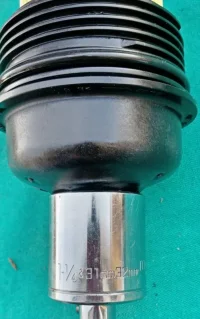

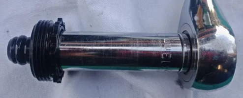

Just done an oil change on my 150, here's a few useful pics for info.
New filter (Mann 501440619 from Carparts4less with code SCREAM100 gets it at £6.30) comes with filter and 2 O rings.
Small O ring goes on the filter drain plug, use this to drain most of the oil out of the filter housing before removing the main body. 13mm socket.
Main body of the filter housing comes off next, My socket is a metrinch, 31/32mm.
Change out the filter and the O rings, there's a handy gap to get a pick under to remove the big one.

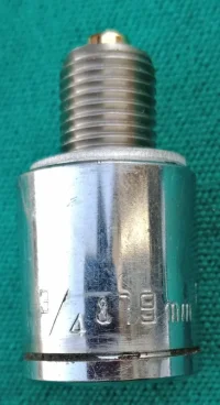

I changed the drain plug for the Gold Plug magnetic version.
19mm socket, tighten sump plug to 30Nm.

The picture description of the filter change in the VW document Pages 100-101 4.29.3 is incorrect for the CXHA engine, it shows a filter that is accessed from above, while my CXHA engine is accessed from below as in the picture in Crallon's post above.
