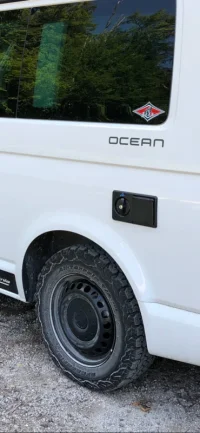

Hi guys new member today 1st post just fitted BFG A T KO2 s on my T 30 LWB blue motion T/line 215 / 65 /16 i got stuck on a grass verge and the guys pushing me off dented the back door panel... seen a couple of vans get stuck with standard tires the B F Gs are a 50 - 50 winter summer tyre and rated top marks in testing as an all rounder the smaller wheels fitted on the blue motion is to help stream line the van. throws the speedo out 5 mph over 40 mph the 70mm tyre would of corrected this but i cant have the van any higher due to a over head shutter and roof bars .. will keep you posted to how i get on with them .... looks a great forum get to meet some of you in the future PS just in the planning stage for my conversion.. theres not a lot of room lol
