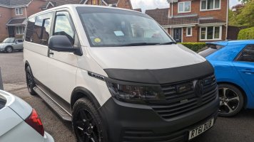

We're running SuperMetal Rockets in matt black with Falken Wildpeak tyres 235/55/18.
