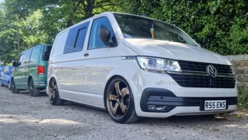

You might be opening a can of worms with that question. Wheels and tyre's are only part of the equation. I had 20" wheels on my T6.1 from new as I prefer the look, but that's a personal thing. Mine is a campervan conversion too and although I never had any issues comfort wise on the standard OEM suspension but it was, as you might expect, a bit wallowy in corners. So I took the plunge and went to see Steve @CRS Performance and had coilovers fitted. I still have the 20's look, the van is 60mm lower (which gets me into carparks more easily) and the handling is excellent (for a van) and it's still perfectly fine on bumpier roads. I'd drive it for a while see what you think. I doubt you will worry about the harsher ride on 20's with OEM suspension.

I asked a client the other day what had happened to wheel sizes on cars over the last 30 years ( and mountain bikes ha ha ) he smirked and said they are getting bigger. I pointed out the standard wheel and tyre on my new IDBuzz was 265 45 20 , it’s enormous ! What doesn’t help however is putting 20 inch wheels on a van that is. Shocked and equipped for 17 wheels that are often 5 to 7 kilos lighter . The Shock doesn’t like it at all. But it isn’t the wheels fault really , we often compound the problem and lower the van with a set of lowering springs , this doesn’t help either . So the wheels and springs take the rap for the poor shocks. . A performance set of shocks. ( adjustable damping preferably ) are cheaper than a set of wheels and tyres !!!!!
The answer is quality suspension equipment , sensible lowering parameters ( unlike the lovely pic above ) and you can have a practical , great looking vehicle with ground Clearance and a comfortable ride .
