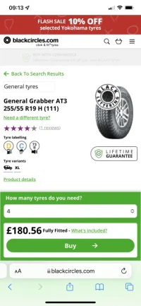

Hi all, I’m contemplating changing over to all weather tyres as my current tyres are slightly stretched and exposing the rim. I like the idea of filling the arches with a deeper tyre without the need to lower. These grabbers do get good reviews. T6.1 Caravelle 32t fully converted
255/55/19 is huge in Transporter terms, it would result in approx 10% increase in gearing over factory wheel /tyre combinations and a proportionate reduction in braking power. Your speedo would read miles out too. (under read)
In my opinion a 10% increase in gearing is too much, others are of course free to disagree!
I think it is way to big - I have 235/55s on my 17” wheels
Appart from being too big, I reckon they'd look complete wrong on that wheel too.
How wide are your wheels? I have the same size tyres on 8" wide rims and they are pretty much flush, whereas your tyres appear stretched.
