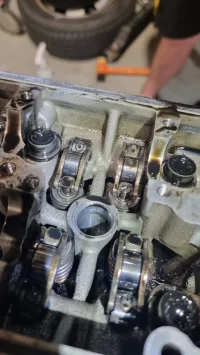

2.0tdi faulty gates timing belt slipped 2 teeth 1 broken rocker

Might not be allowed but it is a 2.0tdi only it’s in my A3! So might be helpful to others. Long story short, missus’ 2011 A3 CFG 2.0tdi 16v on 70k went to local Indy for a timing belt and just over 12mths later slipped a couple of teeth. Apparently there was a batch of faulty gates belts but after 12mths no one wants to know! Any way I've taken the rocker cover off and I can see there is 1 broken rocker. I think I have retrieved all the parts but I’m guessing next step is to get the head off?
So is it time to order a new head or wait till I get the head off?
I suppose head off is the only real way to assess the damage properly.
Also be aware that the cam lobes on the cam shafts might have rotated slightly on the shaft, I don't know how you'd check but I'd consider them scrap now, the risk of putting it all back together and turning the engine over by hand, (as I'm sure you would) then finding that they've turned and the valve timing is still wrong is too great, more knowledgeable people might disagree but that's my opinion.
Thanks for the info. I was secretly thinking there might be a chance of ray of sunshine when I found just one broken rocker!

At a technical level an endoscope will reveal any piston-valve contact without having to remove the head. They probably have on at least one pot, hence the broken rocker.
In addition, the cams are a massive forging (then carburized, quenched and tempered after machining) and the lobe will not have rotated. However, it's not impossible the timing pulley might have rotated on the shaft, although that's not terrible likely. The good news is these rockers are designed to be sacrificial to minimise the risk of damage elsewhere, so there's every chance a new rocker and timing it all up again may be all that is required. Fingers crossed!

And I hope that that's the extent of the damage, you are correct in thinking that you could replace the broken parts, fit a new belt and find that everything is fine.
The trouble is that at least one valve hit a piston, the forces involved are substantial, I think the only way to fully understand what damage has been caused is to take the head off.
As well as looking for damage to the valves and pistons it'd be a good idea to turn the engine over by hand and look for signs of bent con rods or other bottom end damage.

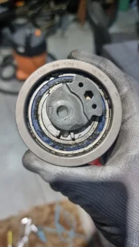

Hi @Westcoast888 sorry to hear this, what was the actual cause? Faulty belt? I recently had a INA tensioner fail after 200 mile on a 2.0 Tiguan, it was some kind of miracle but the belt kept enough tension but put up a cam/crank correlation fault . ECP swapped the kit and offered to pay towards the repair as we use them a lot. (The sump cover is full of oil from the replaced crank seal leaking, reason for a lot of belt failures on the DFS variant)
Anyhow, depends how much time you have but it seems with the new DFS engines you can get away with replacing rockers and swapping cam boxes (if needed). I would replace the rocker, check the cam box frame for cracks and check the lobes for scoring.
If it seems ok, put a belt on and turn it over by hand. If there is no contact then run it, you could pull the injectors and boro scope it for bits sat on the pistons if you wanted.
Pull the sump off and swap the filter incase of needle rollers.
I would try all this before taking the head off but I would certainly be asking the garage to contribute or even do the work.

I think it was the tensioner that is at fault. I have also read something about the design changing along with the method of tensioning. If it was done the previous way the tensioner would be damaged. But I could be wrong!

Yeah, that’s how I found out the belt had jumped 2 teeth. The pump was replaced the same time as the belt and seems to be fine. There was some fraying to the side of the belt nearest the engine so guess it must have tracked over towards the engine
and jumped.DAA1D5D5-C69B-468D-AA89-8F75FD3DFDD9.jpegIMG_5146.jpegIMG_5064.jpeglooking at the middle picture I’ve just noticed the high pressure pump pulley bolts seem to be in a different position to where they might have been before. This photo was taken before any dismantling. We have owned the car since it was 4 yrs old and are the second owners. I had the timing belt changed at Audi when I first bought it along with its first BIG service. So this would be its second change.
