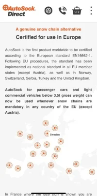

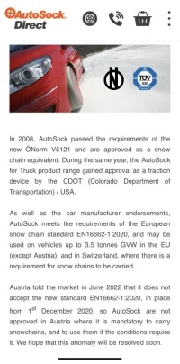

Sorry - should have done some reading before asking the follow up question. Seems to be the case that Autosocks are valid snowchain alternatives. Happy days - but will avoid Austria for now.
