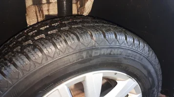

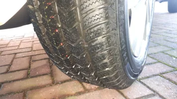

I had these Semperit Vangrip 2's put on about a fortnight ago. I've always had a set of winter / snow tyres as they transform the driving experience. Up to now, they are spot on. Obviously a bit softer but feel really sharp in these recent low temps.
