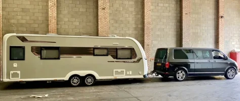

Oh they were the good old days when I used to tow a wobble box ha ha. It was an 875, good piece of kit as well. No problems at all towing with the 2wd 150 Caravelle.

I moved from a motorhome to a caravan towards the end of 2021 and wanted an 875, but the saleman said I'd need something like a Scania or a Volvo F10 to tow it :).

A T6 will tow most caravans on the market - I tow a hoofing great big Elddis Crusader with mine!

I tow a hoofing great twin-axle caravan (just shy of 2000kg, but probably more when loaded) with no issue.
