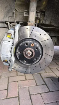

Whats with the uneven marks on the disc
Looks like only part of the pad is contacting the disc ?

That was after just a short drive home. I've only driven the vehicle half a mile and used the handbrake at that
I did a similar job to you and upgraded my van when it was still quite new and had a similar experience, the pedal stayed a bit spongey initially and i ended up bleeding a couple times in between driving it and it sorted it out, i used brembo calipers though so not sure if that makes a difference ?
That picture looks like uneven piston pushing but perhaps just limited usage. How tight is the caliper to the carrier, will it wiggle much if you try? I had issues with the clips on mine being the wrong shape and had to bend them using a picture of OEM as a reference, they then held everything properly.

Hi buddy, thanks for the comment. This was literally from the garage test driving and then me driving it the 0.6mile back from the garage using the handbrake.
I will get it jacked up tomorrow and check the calipers are on the correct sides and check all the mountings are secure.

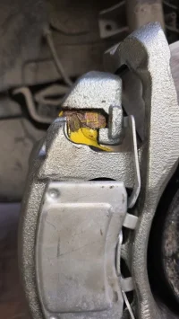

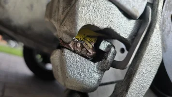

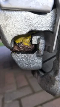

It does sound like air in the system but I wonder if the pads are being held too far from the disk. Two quick pumps may not allow the pad to fully retract if it is being held away by a dodgy clip, possibly masking this fault.
When you get chance, look from the front at the pads. They should parallel to the disc (leading and trailing edge should look the same) and virtually touching the surface.

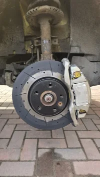

So got the wheel off today jacked up and the pad didn't appear to be sat right. Looks better now and the coating is fully worn off now too.
Bleed nipples at the top for certain too.
Will try and get this bled again. Maybe even using VCDS bleed it using the abs pump

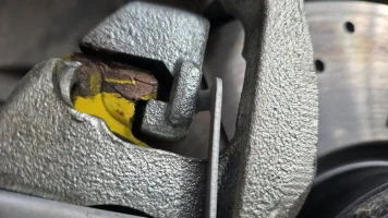

So quick test drive with some heavy braking. The pads have reset to having a gap. Not sure if someone else can grab a picture of how their pads are sitting?
