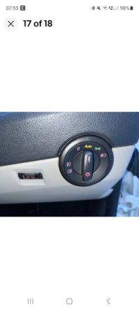

On my 2016 T6 I have automatic headlights that turn on when it gets dark etc.
The only way I know they’ve turned on is if I glance over at the hazard light switch to see if that is illuminated.
I notice the rotary headlight switch illuminates when the sidelights are activated, but not with the dipped beam… so I wonder if someone can confirm if my switch is defective?
Photos attached:
0 - just Daytime Running Lights. No illuminated indication on switch or anywhere.
Auto - same as above but dipped headlights do come on when it gets dark etc.
Sidelights - DRL dims. Switch illuminates green and hazard switch etc illuminates.
Dipped - Dipped beam on but illumination remains red, doesn’t change to green like the sidelights do.
Fog - icons illuminate in the clocks (no photo).

In the first photo, the light bulb on the knobby bit is illuminated to tell you the DRLs are active ??
Maybe that also illuminates when the Auto lights kick in ?
Hi all. I have tried looking at the nights again tonight and even in the dark when set the auto, the dipped beam comes on but the switch doesn’t change from my pictures above.
As far as I know the switch is standard (I’m the second owner). It’s a Highline van so I guess auto-on lights are standard equipment. Is it worth me checking the part-number of the switch to see if it’s one that doesn’t actually light up on dipped?

I think he is saying it doesn’t light up like that. I would like to see positive confirmation between setting the lights to auto and the headlights being on
IMG_4611.jpegMine with auto set at night
Mine set to off at night
I think on my 6.1 when it’s on auto the green sidelight symbol only lights up when the headlights are on. I will check tomorrow when it gets dark and let you know

@Wawlday I was right! When it’s on auto the green sidelight symbol only lights up when the lights come on. Mines a 6.1 Highline with factory led’s.
