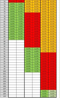

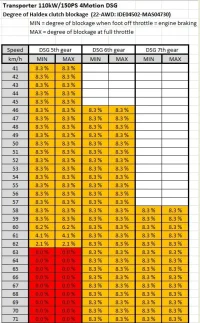

In the table below detailed values for “Degree of blockage” on these vans.​
How to read.​
Pick a line. For example line 80 km/h. R​
On the 5th gear​
  • at full throttle degree of blockage is 7.5% - which is almost as expected.
  • no throttle = engine braking, degree of blockage is 0% - rear wheels are freely rolling which is as expected – ok.
On the 6th gear​
  • at full throttle degree of blockage is 0% - which means the clutch is disengaged – no torque to rear axle, van is front wheel driven.
  • no throttle = engine braking, degree of blockage is 0% - rear wheels are freely rolling which is as expected.
On the 7th gear​
  • at full throttle degree of blockage is 8.3% - which means the clutch is engaged – actually at the maximum for that speed, maximum torque to rear axle.
  • no throttle = engine braking, degree of blockage is still 8.3% - which is not as expected – the clutch is always engaged at the maximum coupling for that speed, maximum torque to/from rear axle.

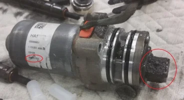

The oil below. It is quite difficult to get a good picture of impurities in oil. In the picture the crater is a wave after drop of oil. The shiny spots are presumably metallic dust, which comes here into view thanks to flashlight. Also worth noting the grayish shiny component of oil in and around the crater. The oil looked like grinding paste (19070 km on that oil).
The garage had discovered a service bulletin related to non-working 4Motion. In short: Coupling pumps will be replaced if two conditions are met: 1) Customer reports of non-working 4Motion and 2) Serial number of the pump is before certain date. Both conditions were met so the pump was replaced.​
In the picture the old pump and it’s oil inlet. Presumably covered with metallic dust. Serial number in the circle on the sticker.

Basically for the analysis is needed to run through all the gears:
(1) starting at about 1100 RPM (or whatever low RPM is convenient)​
(2) click on the Marker and make a note of the gear in use​
(3) accelerate up to 3000 RPM at moderate throttle - certainly can do at full throttle but things happen then too fast :laugh: especially on lower gears​
(4) foot off the throttle and let it slow down by engine braking (down to about 1100 RPM)​
(5) click on the Marker and make a note of gear used​
(6) speed up and select next higher gear --- go to (1)​
Using the Marker button helps a bit to keep track which gear was in use as the 22-AWD doesn't keep track of it.​
Well, probably not a good idea to go up to 3000 RPM on higher gears :eek:
More than happy to look into the collected data, so please post the logfile(s).

Got an opportunity to carry out some experiments on
T6.1 CXFA (110kW/150PS) manual 4Motion.​
Please note the scalings for the illustration:
"IDE04502-MAS04730 - Haldex clutch: status-Degree of blockage" for the illustration (here actual value x 10).​
"IDE06111 - Axle speed deltas [km/h]" (here actual value x 20).​
As earlier in this thread, a concern is that on gear 6 Haldex clutch never releases below 90 km/h - not even foot off the throttle (=the declining slope in the picture).
