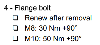

As per the title, does anyone please know the torque setting for the splined bolts that hold the CV joints together on a 4motion prop shaft? I had a look through the downloads section but don't see anything for the drivetrain (unless I am missing something).
Reading for other vehicles suggests it could be 60 Nm, but any specifics for the T5/T6 would be appreciated please, particularly if there is some special tightening sequence.
Thank you.
Thank you.
