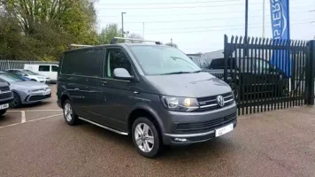

I am currently converting a 2018 T6 4motion (see photo) into a proper overland camper to be routinely driven off-road and on green lanes. To get it right I am going to need some help and advice on underbody protection and rock sliders.
