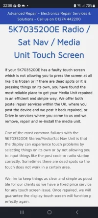

I'm not sure tbh cos I keep seeing pics and literature on the internet saying it has like pic below and that's just one I've found on Internet there's lots .
That is not a navigation unit but the good news is that it is CarPlay capable so you have the option of using google maps etc, if it doesn’t already work then CarPlay/android auto can be activated for a fee
