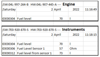

By the look of screen the value seen is from engine controller - not "raw" data - simply because the fuel level sensor electrically connects to dash panel controller. Most likely also the fuel tank size is coded in the dash panel controller to "calibrate" the reported values.
there is EXACTLY 80.0 litres in there !?!?!
The reported value to the engine has resolution of 1 litre and it is just maxed out - that's what T6 does.
Based on the few T6.1 logs I have got it I think it's the same. E.g. on a lengthy ride fuel level on T6.1 went from 61 down to 37 litres at 1 litre steps (144 logged steps en route - credit @Pauly ).
Below snippets of T6 logs from engine and dash panel controller (Instruments) after a fill-up.
