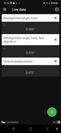

I have an obd eleven and it allows you to view your alignment angle a vertical deajustment in live data. They should be 0.0 or as close as + or - 0.6 before it triggers the fault. I managed to align mine by adjusting the sensor, resetting the alignment angle then clearing the fault codes. Take for a 30 min drive and check live data again until you get it within the tolerances. It’s taken me a few days but I got there in the end. My alignment is now 0.2 horizontal and 0.34 vertical deajustment which is well within the tollerances. Hope this helps someone else

As it happens, I just recently went through the same process on my wife's Golf mk7 which has a similar radar, it got knocked out of the mount by some road debris. I followed the instructions here, largely : MK7 ACC radar adjustment without calibration board which sound very similar to what @Daveoliver51 did.
I didn't go for the full forensic approach to the setup, since anecdotally people were saying that they cleared the fault with much simpler methods like parking 120 cm in front of a wall. So I made a simple reflector from stuff I had to hand - a metal plastering board, couple of lengths of wood for a base and some G-clamps to hold it all together. I placed this 120 cm from the front edge of the radar and as perpendicular as possible (just using a tape measure to achieve this). The point here wasn't to accurately and perfectly calibrate it, more to trick the car into thinking it was being calibrated and to get within the ballpark of alignment - because without that I couldn't clear the errors in order to start it re-learning.
I used OBDeleven to start it calibrating, then used the live data to show the horizontal and vertical alignment values - I don't *think* either of these needed a pro licence. I tweaked the screws a bit to get the misalignment within tolerances (knowing fine well that my setup isn't perfect) and was then able to clear the errors. After that I just did my normal driving and commuting for a week and kept an eye on what those numbers were doing as it was re-learning in use - if they were creeping out of range I'd tweak the appropriate screw.
This seemed to work for me and it's been driving fine now with ACC working normally and no errors for over a month now. I only had to re-do the process once, because I didn't realise one of the legs of the mount itself had been damaged which meant the sensor was still able to move out of place. Once that was sorted, I didn't have further problems. Not an overnight fix by any means, but cost me nothing bar the OBDeleven which I'd been procrastinating about getting at some point anyway. I don't think this approach works on the newer golf's as they don't have adjustment screws - and I don't know about the T6 (I have a 6.1) so sorry if this isn't relevant.
Yes it works on the t6 as that’s what I have! Like you said, not an overnight fix but cost hardly anything. Odb eleven has now coded me a battery and recalibrated my radar.. was well worth the money after all.
