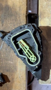

Here's what you'll find inside. This is the wiper arm with the brushes that slide across the carbon contacts as the pedal is moved - don't get them dirty. The arm is well secured onto the square-drive shaft that goes through into the main body of the quadrant - rather than try to pull it off now, wait until the mid-section comes off and it'll draw it up off the shaft with it.

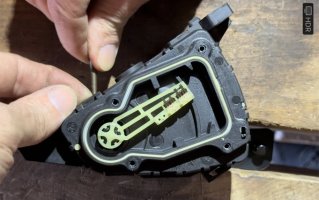

Next up, carefully prise off the 8 clips that hold the mid-section to the main body of the quadrant. I used a right-angled scriber to get it behind the clips; just taking your time, work around the clips to carefully pop them onto the shoulder of the lock until they're eventually all unlocked (it may be a case of going round them all a couple of times to get them all off together). Once they're all released, slowly raise the mid-section off the main body, keeping it level. As it comes up, it'll slide the wiper arm off the shaft and release it all together:
