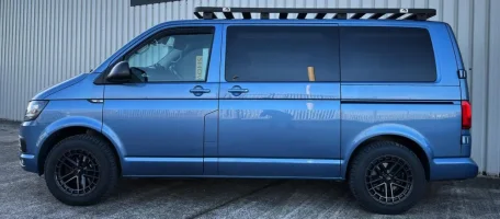

I wonder if anyone has fitted a thule or fiamma awning to their van with a flatdog or front runner style roof rack attached. if so what is the best options for brackets etc?thule.jpg

There is nowhere near enough room for a conventional Thule which is fitted to my other van....
The Thule is aatched to the awning rail below...
And i have just shy of 120mm height to play with under my rack rails...(Using a common datum point to measure from, which looks to be the same on the T6 and T6.1.
I have ascertained the Fiamma should fit but i'm not sure the Fiamma is as good as the Thule.....Tbh I would like to see them fitted to other vans before i take the plunge.
