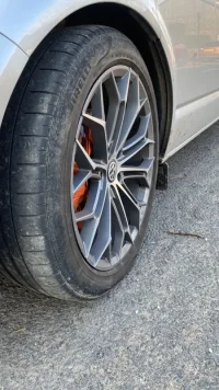

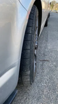

If it helps, I'm running 255/45/19 on B14s on lowest setting, and it's very close under the arches, but no rubbing.
By close, you wouldn't get a finger between the tyre and the inner arch liner.
