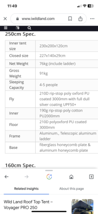

Hi all, iv just purchased a roof tent and not sure which route to go with regards putting it on my roof. Its a large roof tent bein 227cm in length. I’m thinking a rhino rack will be best to spread the weight Evenly over the roof just not keen on the look of them. Any advice will be great to other options other people may have used.

I had a roof rent before converting the van and used the roof rails from Vanstyle which had a 75 kg dynamic load rating along with 3 cross bars. This worked well as the James Baroud Evo was 52 kg which left capacity for a box carrier as well. With the added weight of us in the tent the rail needed some support under the longer span between the front and middle feet which was achieved by cutting a couple of hard rubber blocks to the right size, they were removed for driving. The tent you are looking at has a gross weight of 91 kgs so would need to make sure the rails and bars were rated for that.IMG_1153.jpegedit realised the tent listed was the original post so ignore reference to that.
