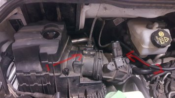

Is the switch marked 1 the mass air flow switch and no 2 the turbo boost switch. 20211121_094956.jpg
Just trying to educate myself. Thanks.

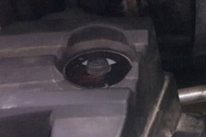

It's meant to show when air filter is blocked, but from what I have read its not very reliable. Has 75% and 100% markers

Is the switch marked 1 the mass air flow switch and no 2 the turbo boost switch. View attachment 137088

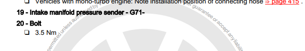

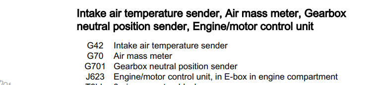

1: G70 - Air mass meter (including G42 Intake air temperature sender) - 5pin
2: GX9 (includes G71 Intake manifold pressure sender) - 3pin
so
1 is Intet air temp and mass air flow.
2 is Intake manifold pressure
