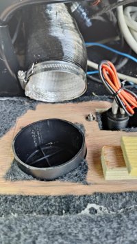

Got some pics?

I notice that you haven't screwed the vent to the board, that will not help if you have a lot of movement there. ( The outer portion of the vent just snaps off to access the screw holes if you didn't know )
Also it looks like you didn't stretch the ducting out before fitting - it looks like it is still in its original compressed state.
Ah, I was wondering how I could fix the vent to the board.
I have a feeling teenagers might have kicked it off the first couple of times, but was unsure when the driver's footwell vent also rotated as if detached from the tube.
