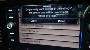

Which menu path did you use, on my MY21 T6.1 Caravelle I don't have any sub menus under Factory Reset, just an apparent global reset?
Hi @roadtripper I did the delete of my account and it cleared it for my head unit and Android auto started to work. What's annoying is that I took mine to a VW Van center and they couldn't get it working . It looks like you just log back in as you get an email form VW saying you've 'logged out'. I'm just glad mine is now working
OK, seems an extreme fix and from what I've read it generally only restores things for a while, usually till the next Android update on the phone. Resetting one thing I could go for but the full set of settings... not so much.

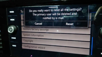

I'm documenting here what I see on my head unit. The following images should be self explanatory
, I hope. Goto System settings - > Factory settings
Once there, scroll down... Until you get to the App-Connect menu item...
Select the App-Connect item and you should see the image below... Just press Reset.
...and you should be ready to go.
I hope this helps.
R.

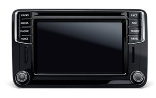

It helps in some ways, you seem to have a completely different set of menus.
Which head unit do you have as it seems to have a SD card underneath?
I thought the base 6.1 head unit had SD cards on the side:
And the other two have none but use USB-C:
Hi, I now realise there are quite a few Discover Media Mib2 units out there. Mine is part number 3G0035869B, with single SD card slot. No Nav on mine.
Depending on the model and trim selected, there seems to be different units. Anyway, did you try to reset your unit?
