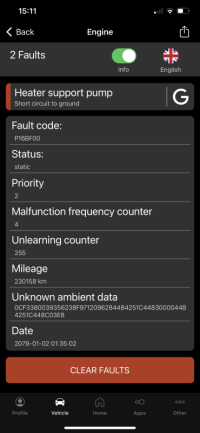

I had an EML come on this week.
Had a look and have the following:
Assume these three are not a coincidence and are related.
Reference voltage error, heat pump error, adblue heater error.
I can clear and they come back, after two ignition cycles EML back on.
I guess I’ll check the heater support pump issue first, seeing as thats shorting and could be causing other errors? Ia anyone familiar with the pump connector and fuse location?
Other ideas welcomed
Thanks.
