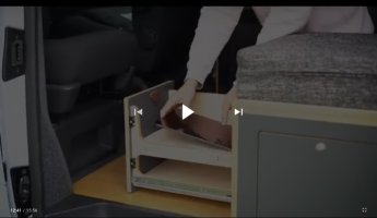

Anyone who has a Loc8 table fitted in the sliding door, do you think it’s possible to mount/demount the table if I were to have this U shape furniture fitted, as it juts out into the door opening, I’ve not fitted this furniture yet or brought the Loc8 table, just wondering if they would be compatible, pic taken 34AF1A3B-C82A-4905-BB14-C2842AB6EF9E.jpegfrom THQ video
Thanks for any advice

Slightly better pic, it looks like it maybe a tight fit, if it fits at all, the table is just for outside use so won’t be used all the time, will have a interior table

I think you’ll struggle re-fitting the table back in the door. You need a hand at both ends of the table under the bottom edge to lift it into place. It goes in top first, then drops down into the bottom recesses.

Looks like it would be ok.
