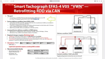

- I'm talking about the tachograph pulse generator - this is an element that in most trucks is placed in the gearbox to directly read the movement of the vehicle - there is no option to place such a sensor in the T6.1, so the function is taken over by a special module that generates pulses based on information from the CAN bus - it needs those parts of additional harnesses that plug into the standard installation to complete and connect my (already purchased) tachograph 7LA.957.041 to my T6.1

For today I have a set of TACHO + sensor + antenna - the whole thing comes from VW Crafter /MAN TGE - so the sensor itself may not be suitable - not suitable for my T6.1
