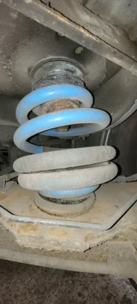

@CRS Performance sorry to bother you - I have rear clacking when completely unladen, i thought it was a slider roller rattling but the youngest rode in the back and says it's coming from the floor where the suspension is. am just wondering if I can quiz you. I have been under my van rear to see if my ARB bushes are perished and they look okay? I have a feeling the clacking noise I'm hearing at the back is actually my springs. I think the springs are fully touching at the bottom (lowered on bilstein so squished at the bottom) when I'm laden but when I take everything out they aren't binding and subsequently are knocking on themselves...
