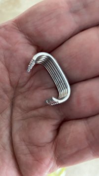

So I installed the £30 EBay armrests and they are superb. Make a big difference to driving comfort. I did need to improvise with the position of the bracket that bolts to the seat frame - but that only meant drilling a single extra hole in each side. One question though - the kit came with some unusual metal clips (pictured) that, as there were no instructions, I didn’t know what to use for. Any ideas? IMG_7816.jpeg
So I installed the £30 EBay armrests and they are superb. Make a big difference to driving comfort. I did need to improvise with the position of the bracket that bolts to the seat frame - but that only meant drilling a single extra hole in each side. One question though - the kit came with some unusual metal clips (pictured) that, as there were no instructions, I didn’t know what to use for. Any ideas? View attachment 200239
They are hog rings for securing upholstery, use pliers to squeeze together to pull the fabric tight.
