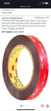

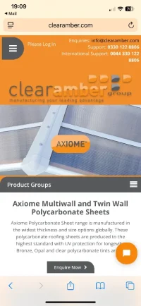

So I’ve just fitted an 80w panel from Lensun on Twinwall. The Twinwall is fixed to the roof using VHB tape and the panel fixed to the Twinwall using plastic bolts through the eyelets. My thinking is if the panel fails I’ll just unbolt it from the Twinwall and fit another one and I’ll have plenty of airflow under the panel

Yep all good still, done a fair few miles with it on, the secret I think is good quality tape, clean surfaces and warm weather when installing
