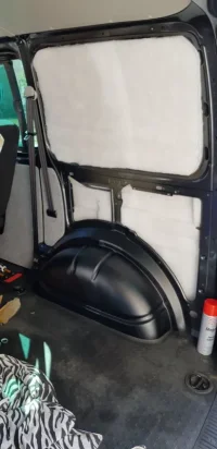

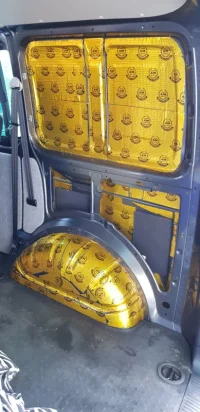

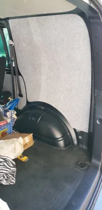

So i am slowly going round the van, Auto mute on everything i can get to. It is razor sharp on the cut edges but all seems to be going on well and certainly makes the panel much more dense. I have then put mega van mats dacron insulation on top. Then carpeted the original panels and fixed back on with Harrison's hidden clips. Still got the roof and front doors to do and everything feels a much nicer place to be already no rattling and definitely quieter. 20180715_150710.jpg 20180715_153216.jpg 20180715_161019.jpg

Question .... where did you get the wheel arch protectors from?
^^ like the pictures ....
I think they are vanstyle, VW got me them after a Muppet technician made a mess of the arches in my last van a 5.1 never fitted tthem so i thought i would put them to good use.
