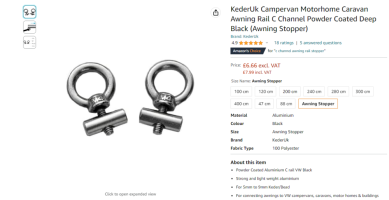

@VanDamMan put us onto these:
c channel awning rail stopper - screwed into the crail at each end to stop any sliding?
Does anyone know if these will fit inside the Fiama F45s?. .The dimension stated for Fiama channel is 4mm, but some are saying that 6mm will fit inside...I am a bit confused...(not really unusal for me )
