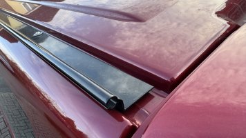

Any 1 have a similar awning rail that at the end doesn't sit flush to the body (about 10mm off) and what have you done to stop the flex.. slightly worried on a windy day with the awning on this could flex and damage the body work.. not a great design really??

No, but I've removed mine and will be fitting a reimo rail tomorrow. Used one of those rails last summer and the kador strip would tap against the van when windy, which was not only annoying but also took the outer coat of paint work off

So you didn't have this weird gap at the back with your previous awning rail? just wondering it needs a gentle bend to follow the bodywork.. tempted to fit a rubber strip underneath too
When i fit mine i gently bent it to form with the contours of the roof. Works fine.

That's what I would do.... Fit a rubber strip underneath.

Ya it’s a good shout.. just makes me feel sick drill holes in a brand new transporter! No one else found they rub the bodywork as fairly close??

The c- rails are bolted to the van roof with rubber washers underneath.... So the rail doesn't touch the paintwork.
But as you see, with your looser end and some wind, it could rub the paint.

No weird gap. When I removed it I did notice some slight rust marks underneath where it was touching the van so rubber would probably be a good idea, maybe some decent rubber washers ‍♂️

When connecting the awning it was the figure of 8 attachment thing that was tapping on the paintwork in the wind if I remember correctly. So if it's only going to have a canopy which slids straight into the rail then you won't have this issue tbf

Ya going to have to see if can bend so snug and no movement. Ordered some rubber to stick underneath.. on my old van must have had some movement and grit had worked its way in was starting to affect the paint finish when I removed for sale :( not 100% convinced these c sections are good for bodywork??

Some 3mm rubber strip underneath the crail should stop any rubbing.
