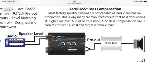

I looked at the Audiocontrol website, are these the kind of thing to take the speaker level outputs from my factory head unit and prepare them for input into an amp/amps?

I already have a piggy back loom with rear speaker outputs so could I tap into this so that as well as powering the rear 6x9s it could also go into the Audicontrol as a speaker level input to then give me a sub output which I could run into an amp and then to the two subs?

And this is just taking the rear factory channel and using it to add a sub line out…
This would actually be simpler because all I would need is to use the R channel wires that already break out from the headunit loom and I would just need to re-route them to under the drivers seat.
I assume I can still use the R ch with my 6x9s as well as feeding into the LC2 - or is it one or the other?
