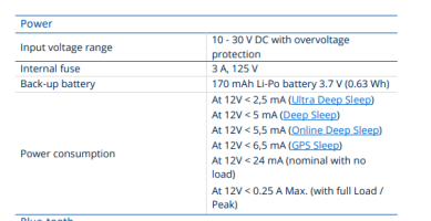

the tracker spec states:
25mA - no load ( so in sleep mode )
to
250mA - full load ( awake and transmitting data )
so, depending on how often its reporting its location etc it will use more power - ill assume this is you main source of the battery drain?

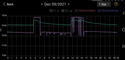

The van was driven for 2hrs on Friday, when parked up at 4pm it was at 13.1V, 24hrs later it had dropped to 12.8v. It then dropped to 12.7v last night but has gone back up to 12.77v now however I believe its a sunny day at home and could be due to solar.
Before its latest trip out on Friday the battery had dropped from 13v all the way down to 12.11v at its lowest which I believe took around 4 days. I then bottled it and asked my dad to take it for a good drive.

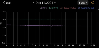

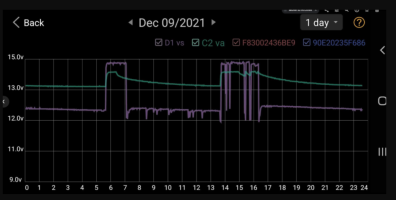

note the voltage drop offs after the engine run / battery charge.
