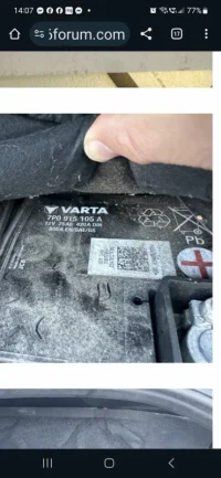

Yes they disconnected & noticed over the test period draw went down but still happening somewhere, they then went thru all fuses and modules one by one over the week. they thought that the aircon reset would give me a month without having to charge but here we are 2 weeks later and N/A. I did take the van to VW in Southmpton first - they ran tests for 24hrs and found nothing and said battery was fine - which lead me to the garage I've just used. The battery i presume is the original fitted. I've attached pics of battery and also the report they generated which details their work if thats helpful
Get the battery retested, I would be very surprised if it is fit for purpose at that age as it looks original. Not all battery testers give equal results, so a good idea to get it tested from another source. If you have a voltmeter and charger, charge the battery and leave it disconnected. Now monitor the voltage over the next day of two and report back. If the battery is very good, I'd expect it to maintain 12.7 volts easily. If it's weak you'll find it dropping to 12.4 volts quite quickly

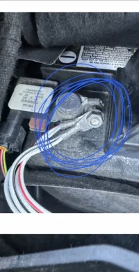

I'd definitely test for drain with those 2 direct grounds (I suspect towbar electrics?) disconnected and long term move them to the nearby bolt on the inner wing.
20230711_093233-jpg.205144
These need moving from the neg post to the chassis.
The light brackets bolt works well.
They are bypassing the power monitor on the battery.
That battery looks like the original.
They are rated 3-5years.
You may get longer if it's looked after.
I'd look at replacing the starter battery as well.
It's defo a cheaper option.
