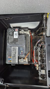

I have a 2018 T6 Startline that is about to be converted. I will be adding a leisure battery for diesel heating, lighting etc. I am looking at the Roamer 230SEATBASE4 or similar. I would also like to add a powerstation (Ecoflow Delta 3) that can be removed from the van if requried, but that will charge when the vehicle is being driven. The van already has an auxiliary battery under the passenger seat (photo attached). This would result in 4 batteries being charged when the vehicle is being driven. Would this be possible? If so, what is needed to make it happen? Ecoflow have their Alternator Chargers. I have also seen various references to DC-DC Chargers, but I have to admit that I don't really have a clue.

so you need to swap the OEM battery for the ROAMER - good move

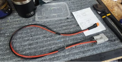

you can add in a SLOW CHARGE, by connecting the EF to the 12v battery like this. . .
basically a 8A max connection to the LB (leisure battery)
