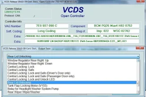

I've connected VCDS and in Module 9, I've enabled what I can see for the tailgate. When testing an output, there is an option to test for Rear Lid Unlocking but it gives a message "This output is not supported by the control module". I hope this doesn't mean I need a higher spec BCM.

I have the test - see below, and indeed it unlocks the rear lid. All the output tests by @Dellmassive --> Dodgy Demister

Testing the output in Address 09 didn't work. I kept getting an error message.

Just looked into your coding - it looks like "byte 2 - bit 3" made the BCM aware of motor and enabled the output test.
A0 A4 31
A0 A4 39
Byte 02 Bit 3 Central Locking/Rear Lid: Spring motor (unidirectional) installed
The byte 7 has a bit for another type? of motor - and it is coded differently than mine. See --> VCDS codes list
Probably wouldn't hurt trying to change the coding from
A0 A8 39 3A 0A 61 34 B1.... (yours now) to
A0 A8 39 3A 0A 61 34 91 or
A0 A8 39 3A 0A 61 34 11 (as mine)
which would be changing B=1011 to 9=1001 thus changing the Bit 5 to be same as mine and as @andys in Dodgy Demister . Unfortunately the bit 7 isn't documented.
I think @Dellmassive has barn doors, and his coding for this byte is "31" = 0011 0001- so hopefully the bit 5 is the key...
Byte 07 Bit 5 Central Locking/Rear Lid: One-Motor-Lock installed
Thanks you !!! Success..
I quickly tried changing the coding from
A0 A8 39 3A 0A 61 34 B1.... to
I tested the output using the VCDS and the lock opened. Checked it with the door handle and that works too.
