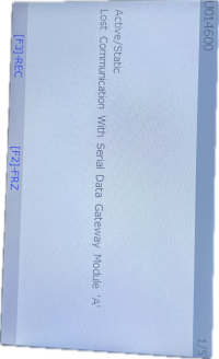

I have 2 faults coming up as per picture .
Van will not lock ,interior lights don’t work, right headlight does not work ,
Says in coms from gateway and terminal 30 is open.
Any ideas to point what this could be please.
The picture is "only" Gateway installation list - listing of controllers in the van.
Please make a full scan and post/attach the result file.
Need to click on "Start" and when finished "Save" the results into file
