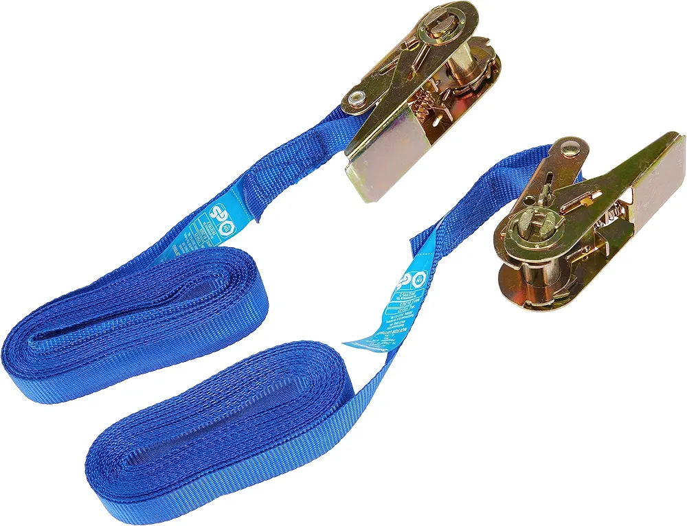

Another option I've used in the box trailer is a board with grip underneath and a hole cut, each end then I just thread a load strap across through both over the top of the board and ratchet down - I smoothed the edge of the holes flat and radiused.
That works as it holds stuff behind it away from the roller door, might not work as well if you need to mount stuff on the board.
Advantage is load straps generally useful for other things.
