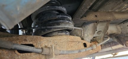

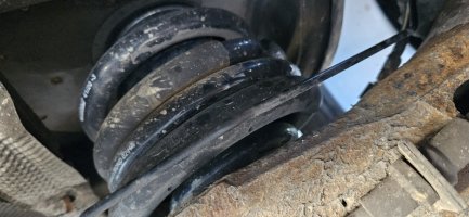

Thought I'd just post up some pics until giving Steve a call next week.
Bear in mind this is a unloaded Kombi with just a few bits and bobs in the boot. Imagine if its carrying rear passengers and/or boot full of heavy tools.

I was looking at change the ARB's and while underneath at the back noticed the springs are coilbound like the picture above.
I have been back to where they were fitted and they said all was well but from what I'm reading here, they're not right.
So should I go back to where they were fitted and ask them to sort it?

A very common issue , we have removed so many of these because of the problem you have . The spring isnt coping well with the weight . The big issue is that the top and bottom pigtails can stretch the spring steel to a point it shouldn't go to . the upper rubber spring seat plate is removed to fit coil overs so it cant protect the spring from over stretching it self . I need a picture to explain this better , let me see if i can find one ,
The rear springs supplied with most coil over kits are the same for all transporters T 28, T 30 , T 32 and non of them are rated to carry a ton .
There isn't anything the installer can do to fix this . We dont sell these kits at all but we have a fix for the problem as its very common
A very common issue , we have removed so many of these because of the problem you have . The spring isnt coping well with the weight . The big issue is that the top and bottom pigtails can stretch the spring steel to a point it should go to . the upper rubber spring seat plate is removed to fit coil overs so it cant protect the spring from over stretching . I need a picture to explain this better , let me see if i can find one ,
Ok thanks for the reply, so would a more sturdy spring not compacting so much make the van handle better noticeably? Is that the fix? New springs?
Yes spring and adjustable perch needed . noticeably better on the rear . it wont make any difference to the front sadly , but its less of an issue
