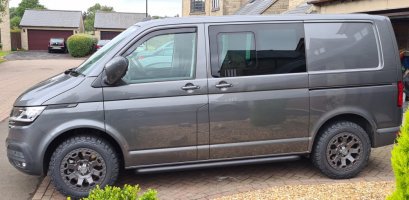

Oli - OK picked up my new 17" Warlords with BFGs 225/65/17 - running 48psi (Front) 44psi (rear)
Still on standard T32 4M suspension , and getting a lot of tyre noise from the rear when above 30mph - so plan to sound deaden the rear arches this weekend in a bid to reduce road noise.
Do you think I need to drop my tyre pressues any as the T6.1 on carries 2 people and bikes in total 300kg max.

Looks nice with those wheels! Are you getting tyre noise because of the chunky tyres or because you don't have sound deadening and are you enjoying the ride overall? I currently run 20" wheels lowered on KW coilovers but considering going down the lowered swamper route in order to help with the dodgy roads around where I live!
They're bound to be noisier than a standard road tyre, it goes with having that blocky bold tread pattern.
74db is noisy compared with most tyres, my M+S rated tyres are 69db, most tyres are less than 72.
I've sound proofed internally with 2 x 2mm dodo and dodo 10mm deadening and insulated with 35mm roll.
Then externally I've 2mm Dodo SP and 10mm Dodo SD all 4 wheel arches.
This has reduced the rolling noise somewhat.
I've been playing around with tyre pressures and think I have it the best yet with 52psi Front and 44psi in the rears.
This seems to give me the best ride on the roads I use as it seems the less psi the more the tread is pressed into the road surface and with that actually increases the road noise.
Today I finished replacing the OEM panels with 3.6mm ply and carpeted them, not really drove it as yet.
But will update you once I've taken it for a run.
