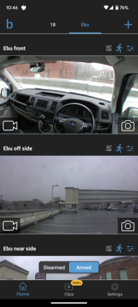

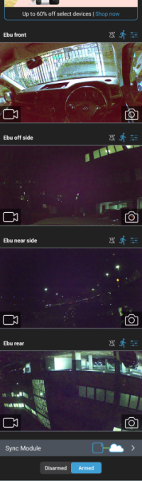

Brief update on my system so far:
1. It eats data if you sync to the cloud. So I've turned that off.
2. Car headlight set it off. So I've turned off notifications.
3. I use the Sync module and it doesn't seem to bad on USB storage. Initial USB set-up was a faff with formating but seems ok now.
4. I think I need to re-format when USB full, not sure if it loops.
5. I used window mounts from Amazon and used some spacers to point the cameras down a little. I think they need to point down more though.
6. I'm using indoor usb powered mini cams. I turn off night vision so they work through windows. I heard the battery cams use PIR and you can't use these through glass.
7. I don't know what the amp hours they are consuming. I've got a lithium leisure battery and solar panel and I've not really noticed any dents in the battery.
8. Yes, a robber could take the USB and hence the footage.
9. What I like is I get live view. Ideally I'd like a 360 dashcam but these don't seem to provide live view.
10. I bought them for when I often have to park on the street whilst working.
11. It gets internet off a mifi thing in the van from TP-Link.
