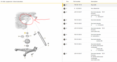

Just had a quick look and this is the diagram
The actual bump stop is part number 4 and the part number for that is 7H0501191B but i am assuming you want the plate that i have circled in red ? this is not showing as a part so may be shown as part of the chassis ?
Hi Pauly,
Yeah its the mount that you circled in red, i couldn't seem to find a part number, i guess because its part of the chassis...

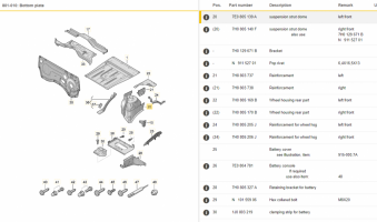

Just scanning through the chassis/body stuff now but cant seem to find it, this is listed for the front and shows replacement turrets for the front but cant seem to find an equivalent for the rear
Appreciate your help Pauly,
i've struggled to find anything on the rear, thats why i posted on here, i came to a dead end

Im at a loss, just been through all the sections on etka and cant see it, i am going to guess it will be considered part of the chassis
If you contact your local dealer/parts department and point them towards that picture (ETKA illustration 511-000) if they also cant find it they can raise an inquiry up the line to VW technical who will come back with a definitive answer, normally takes a few days but at least you will know for sure one way or the other
