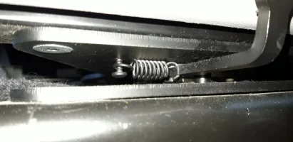

Can anyone with a RIB swivel post a picture of the mechanism? I've picked up a broken one
Looks like you're missing a spring -

And looks like the pivot post is sheared off?
Yep, I've been attempting to drill out the weld to tap a bolt in place but even a cobalt bit isn't making an impression. Plan B will be to weld a post back on. Spring is the easy-ish bit!
