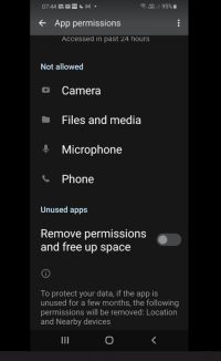

also you need to make sure that you have given the APP all the permissions it needs when installing. . . like location, photo access etc etc etc.
if you block any permissions it will stop the APP working.

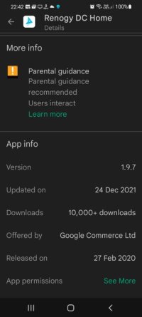

FYI . . . these are the permissions my Renogy DC Home APP has on my phone/tablet.
these are the APPS.
New APP - DC Home
old APP.
Renogy BT . . .

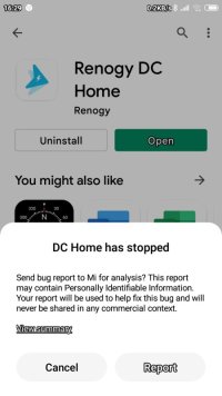

Thanks for all that Lee. Im still working on getting the fuse box sorted but the first thing I had to do this morning was move the vehicle off the road as the tipper lorries were getting too close to my legs. I think I’ve found the place where the fuse I dropped came from which by coincidence appears to be the tail lights again. I’m waiting on a piggy back lead which should arrive today to use for the ignition connection. Everything you suggested has been tried as I also believe it’s one of those things. The blue page with the wavy line comes up and actually shows the name of the charger/controller but almost immediately disconnects and leaves a notice saying the app has stopped with the option to send a report, retry or cancel. I’m stubborn though. It must be something simple or obvious I’ve missed so I’ll keep trying, maybe that other app and all the permissions again. It’s frustrating that things have gone a bit pear shaped when the job was coming to the end but my priority has now become to give the van a good run to get the starter charged properly and check the actual system is ok. My son is viewing a house in Reading tomorrow so I’m trying to clear it enough for him to use. I might sit in the back with the fire extinguisher ready! Watch this space

"Went through three more reinstalls and once managed to log on and follow the permissions prompts. Just when I thought I’d cracked it the app switched off again. After reading all the negative feedback I’ve decided I’m wasting my time. As a consolation prize I’ve managed to get a bluetooth link with their Renogy BT app but it’s not so comprehensive as the BT-2 Home app.
First screen shots are the error message and some of the analysis.

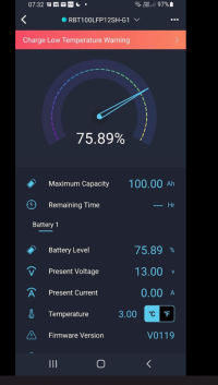

Second screen shot shows typical of the bad feedback
Third screenshot shows what the new app looks like…a list of data, no spreadsheet type of view and no live graphs like that little BM2 battery monitor I was using yesterday.
