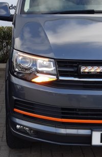

Hi all, I'm still having a couple of minor issues with my new headlights. I've been running with v2 travelin-lite units for nearly 2 years, no real issues I just wanted something better, so I've had my oem t6 units modified as per pic; bi-leds, switchback drl strip at the top, led indicator bulb. Fabulous output, really can't fault it, I'm especially loving the indicator output. But I get a bulb out warning when I use the indicators; no hyperblink, in all light settings. I've got all lamp diagnostics off as far as I know, anyone got any ideas? Wondering if a resistor is missing, or whether I should try a hard reset.

Who did your lights please and do you have any other pics, thanks
Work done by EMTUNING. A bit of duff video attached, not the best quality I'm afraid, the indicators look a bit yellow but they are in fact a vibrant orange...
