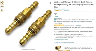

Use QRC's so you don't require spanners or the need to tighten jubilee clips etc.

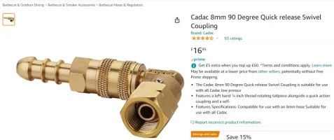

Male QRC end on your Cadac. Cadac do a 90 degree swivel version:
Then join you BBQ point to the Cadac with 8mm gas hose extension lead with a male QRC on 1 end & a female QRC on t'other.
Job done. :thumbsup:

Ok, but just be careful if you have already connected a hose up to your underslung gas connection at the rear of your van, as using that supplied screw on connection will allow gas to escape if you don't connect it to your Cadac 1st.
A QRC wouldn't allow gas to escape from the female end of the extension hose before connecting it to the male end fitted permanently to the Cadac.
